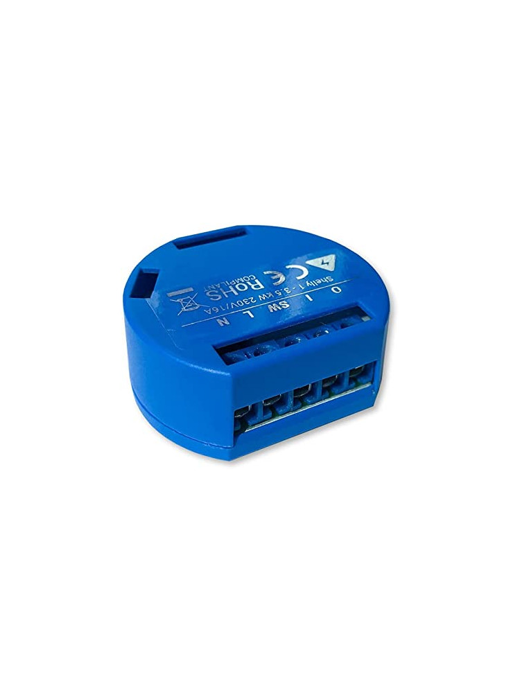

Shelly 1 job done.
Nothing about the remote changes, it works as per normal.

So you buy one of these.
and then you watch this video.
Now the REED switch will depend on what you are already running, I didn't go for the wired version as I have Zigbee Aqara sensors already so I just use of those and configured it in Home Assistant to work with the Shelly as a Cover Entity.
But if you want to go wired you can just buy one of these cheap alarm magnets like he uses and then you need to find a place close enough to the motor to wire it up....or if you want to get advanced tap into the motors own reed but I don't have a Centurion so can't comment there.

That's firstly AC (which may or may not work) but also has no option for inputting any sensor data.
Which is fine if you are going the wireless route as HA can then do the work.
Basic is also going to be a problem to fit inside the cavity I reckon. Wrong product for the job in my opinion.
The Shelly is smaller, supports AC and DC, natively supports a sensor and works directly in Home Assistant.
Much better option than a Basic.
I ended up installing a Shelly 1, which was much easier than I expected, and it works like a charm.
