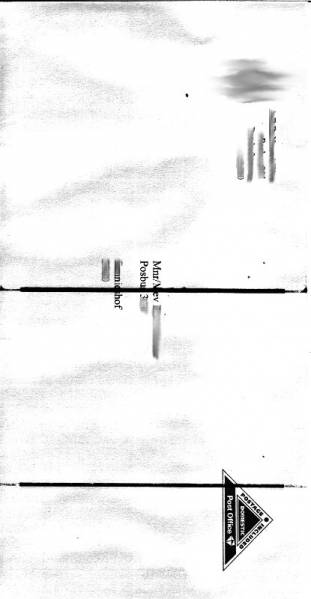

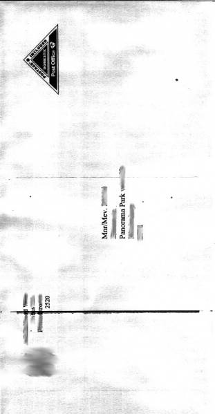

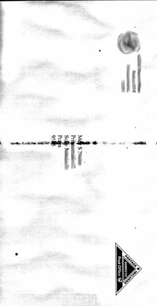

Here are some of the samples from envelopes we printed:
And this is the worst it has gotten so far:
