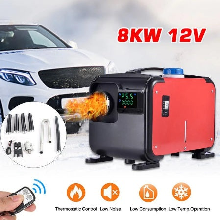

8000W 12V Diesel Powered Portable Home/Workshop/Car/Bus/Truck Heater System - Electromann SA
these diesel heaters are stupid efficient, 100ml diesel an hour. . simple to operate. Yanks run these in snow conditions.
