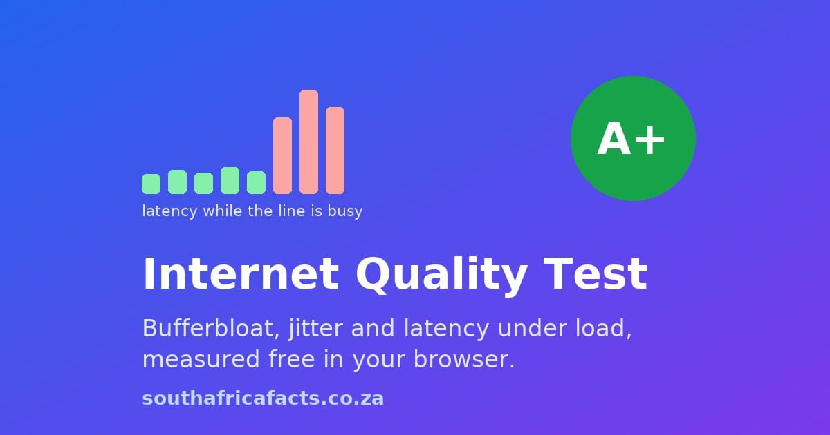

I have build a Internet Quality Test tool.
A speed test tells you how many Mbps you get; this tool test tells you whether your line actually holds up when it gets busy. It measures your latency on a quiet line, then again while deliberately saturating your download and upload, and grades the difference, called bufferbloat, from A+ to F.
Anyone interested can have a look here:
Looks good - you're building up quite a nice set of tools there
