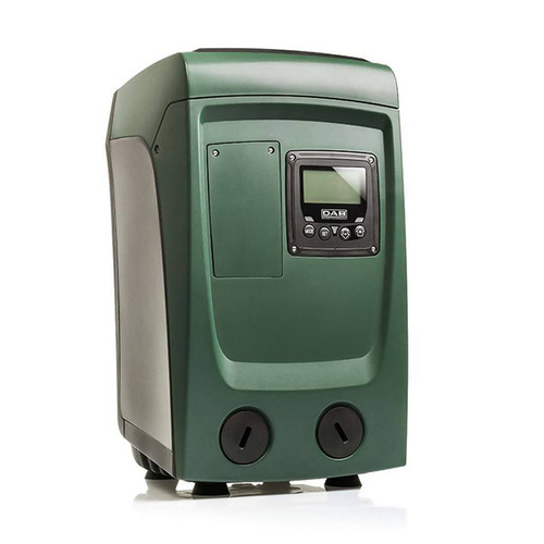

My main question now is on which pump to use from the Jojo into the house. They do have some general guidelines on websites but I'd prefer to hear about actual experiences if anyone has one of these pumps fitted.
The intention is to ensure I have minimal hassles once we're off the grid without spending unnecessary money. From the forums it seems DAB pumps are great value for money. I've found a reseller with really good pricing but not sure if the higher spec will be required. I have a cottage on the property for the in-laws so assume 2 households (2 showers could be running simultaneously with a washing machine etc) with 5 people in total. The sprinklers i can set to run outside of showering times etc and we can control the washing machine /dishwasher use for during the day or late at night (cottage i can't fully control unfortunately). Will the lower spec pump take a bit of strain, or is the bigger spec an unnecessary expense?
Larger 1.1kw pump
https://www.mahpumps.com/product-page/e-sybox
smaller 0.75kw pump
I had an e.sybox. Great pump, very quiet and efficient - so much so that I just left the water supply running through the tank all the time, with the pump always feeding the house. Stable consistent pressure and we never even knew there was a water outage until the whatsapp groups went mental.
Bear in mind it's an inverter pump so it only runs at the necessary power to provide the flow and pressure being demanded at that particular point. Mine generally got to a whole 300W at peak usage.

Larger 1.1kw pump
smaller 0.75kw pump
All depends on your flow rate and pressure required. Generally many households who have a standard .75kw booster pump struggle once a few taps are open. The two main drivers to look out for are flow rate and then pressure. Hence it will be better to get a VSD (variable speed drive) type pump so you can then control both the flow rate and pressure. There are not many good quality VSD pumps around and the E.sybox seems to be the most popular here in SA.
I have the 1.1kw E.sybox and can highly recommend it
The pump remains in standby until a tap is open so there will be no need to manually turn off the pump for your scenario above.
