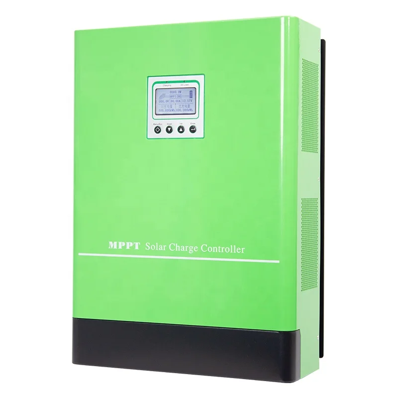

pricey mppt to add solar
so a person can make it work but if wanting to expand later with solar niche products makes it expanse
