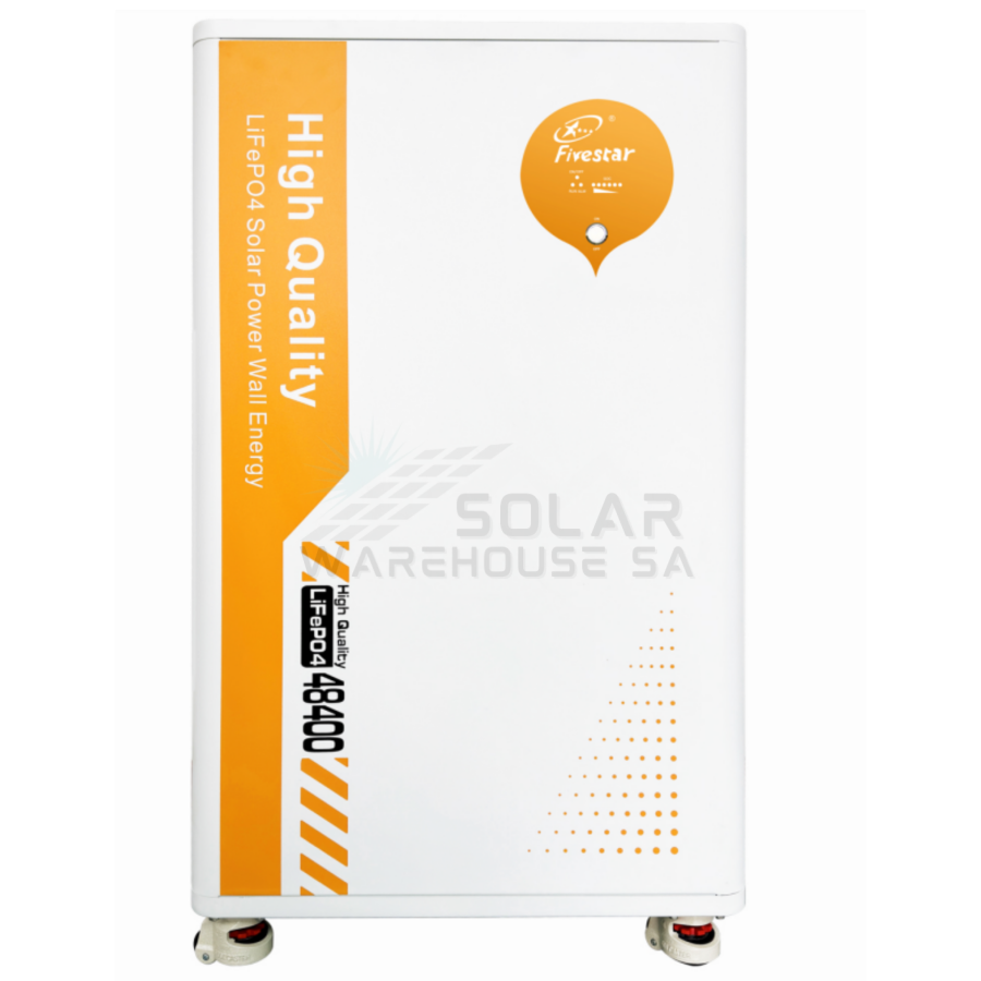

Okay, how will you connect this 5A balancer? You'll have to remove the pack to get to the back right? If you going to go all radical like that, may I suggest to follow the "while I'm in there" doctrine and just source some new flat terminal cells or another (better imho) suggestion, go full "a boer maak a plan" and replace 5pcell8 pack with some thick cables going to one big prismatic that sits on the floor next to it like a proper caveman?
I was looking at that one before. Seems like a nice battery. Same with the omnivolt
and the Five Star
If you go for a single big battery like that 1 BMS does the entire load. Even for my small solar setup just running the geyser is 70amp. That is going to be quite a heavy load on a single bms for a very long time in terms of powering loads and charging.
All of them see to use PaceBMS or a custom branded PaceBMS.
