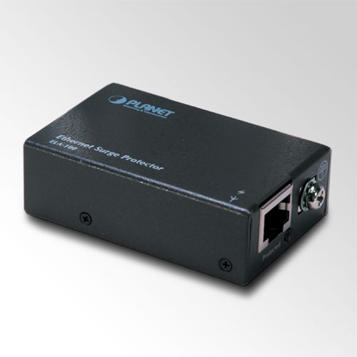

Totally: I've had to convert one (home) office to all-wireless for their network because surges induced into the network wiring was killing things. Also, at my own office my last batch of IP cams suffered greatly when we had a good light show overhead; last year one I JUST put up got fried later that same day. My new cameras have at least a modicum of protection to fend off the furies and so far so good! And for the cabinet/switch side, I've got my eye on a bank of these babies.
