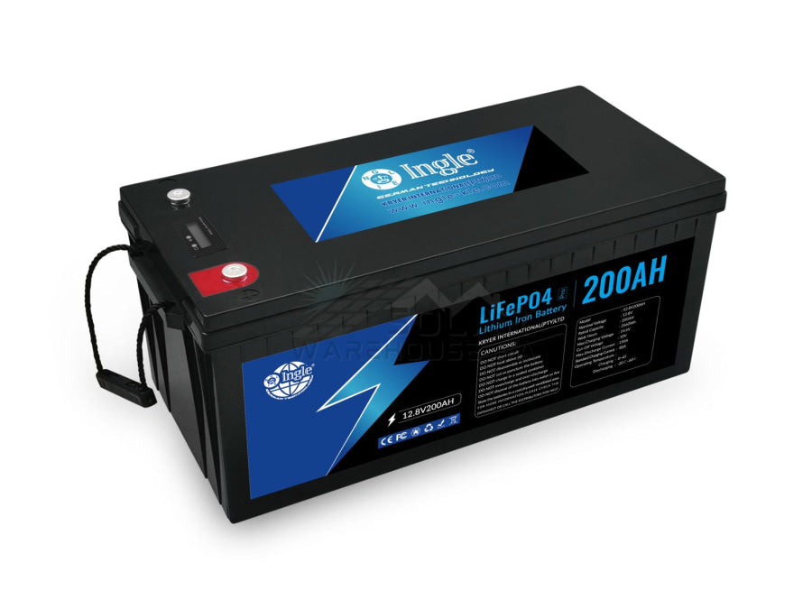

Does this look like a good deal and ,
is this part correct
  • 3000 cycles @ 50% Depth Of Discharge (DOD)
