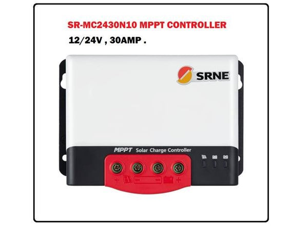

Something like this would still do https://www.electromannsa.com/produ...ace-t20-lcd-wholesales?variant=43383935140081
With having it use solar only, yes it would work but it will still dip into the battery to take some amps that it needs, depending on the charge cycle that the MPPT is on.
Having it automated is possible but heck will require alot of additional work and a mix of stuff, relays and so on to actually make it work.
