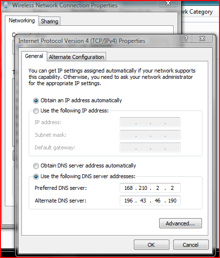

okay here is what you do, go to the TCP/IP v4 setup on your wireless/lan card.
For DNS server, change the obtain DNS automatically, or on the router setup.
Put the following vallues for DNS:
This will solve the problem hope I could help.
