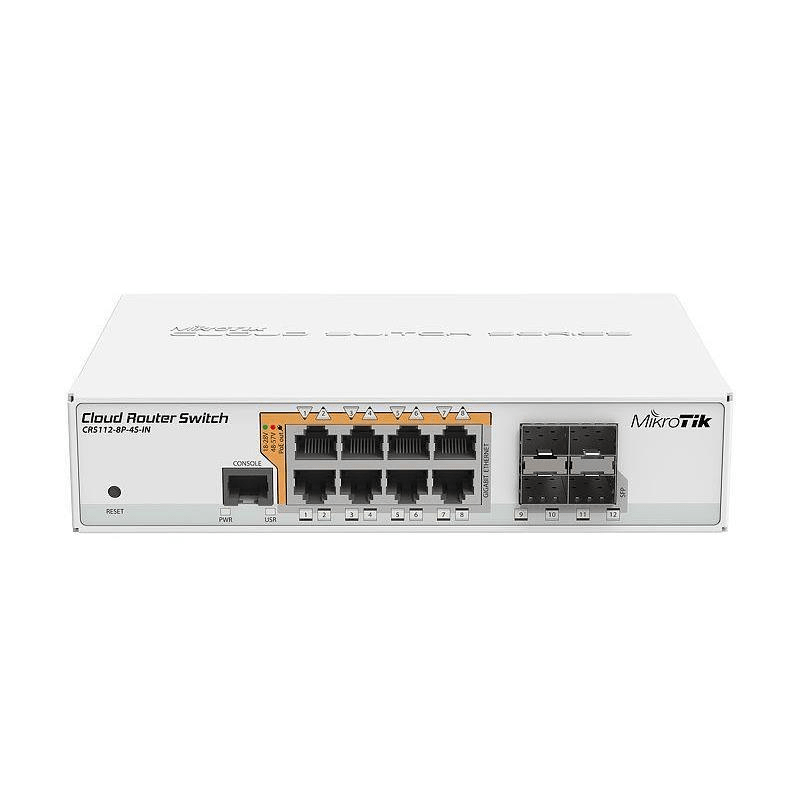

Is there any other, preferably cheaper poe switches that handle both passive AND active poe?
Does this handle passive POE as well?
Can't pick any specific reference to that?
It senses if the line needs power or not and supply's power if needed .
I have been running one 8 and two 4s for a while and they do the job .
