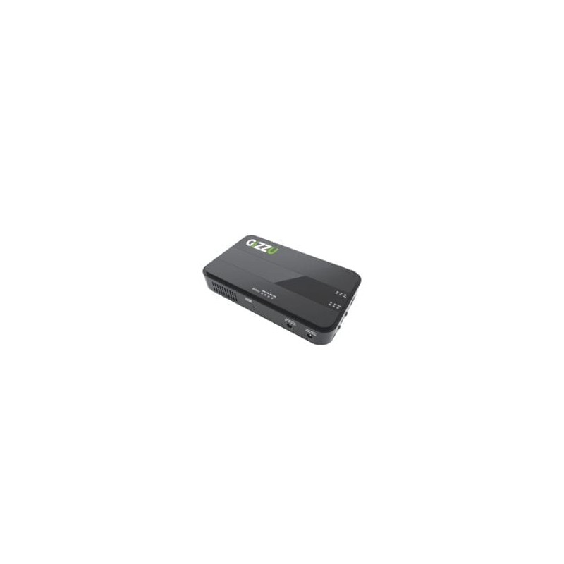

Get one of those R1000 Gizzus and dedicate it to your internet. Your internet will never drop and it lasts for years.
For everything else, I would recommend a Ecoflow or Bluetti. Get over 500wh so that you have got some extra headroom for 4 hour sheds and don't need to charge it twice a day. With the lipo4 battery it should last many years.

Not years but after 2 years my Gizzu takes about 5 hours to run router and fibre box. Gizzu 100W model with thew newer LiOn battery
The Ecoflow is good otherwise. If you can get the bigger one. Works well.

i would honestly buy none of them. That 8800mah units is crap. Great for using for lights if you buy those usb light sticks from chinatown. But I wouldnt run a router off it.
6 months and you really turn it into a battery unit for a light instead.
