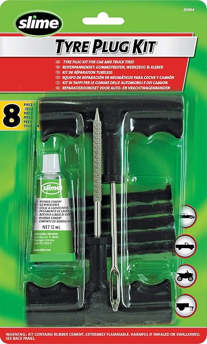

I bought a plug kit from the petrol station and did it myself.

Try Ascot Spares and Hardware opposite Police Station they may have a kit.
Easy to do.
Pm me your no and I'll talk you through it if you wish.

Very easy to do...
Just do it at the garage where you can re-inflate afterwards. But if you do it quickly you don't lose alot of air.
Thread the plug through the needle first and cover with the glue.
Then screw out that screw and quickly re-bore with the bore tool and shove in the plug as deep as possible and pull out slowly so the plug stays behind.
Wait a few minutes and inflate...job done.
