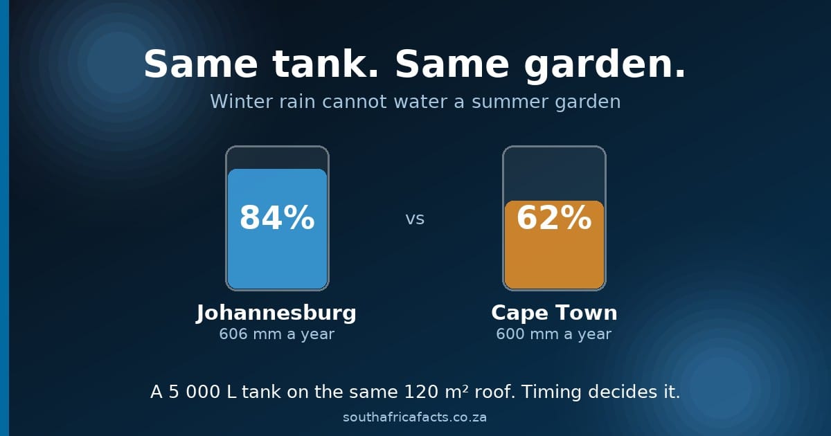

Harvesting Rainwater can save you water, but you must first do your homework. I have build a calculator to help.
Most rainwater calculators multiply your roof area by one annual rainfall figure. That hides the thing that actually decides whether a tank works: when the rain falls relative to when you use it. This one runs a day by day tank simulation against ten years of real rainfall for your town, then tells you the smallest standard tank size that covers the share of your watering you want.

Quite an interesting concept, with a lot of useful details added! However it confirms my opinion that rainwater harvesting in Cape Town is a waste of time and money, due to the seasonal mismatch between rainfall and demand. Our Body Corporate bought tanks during the Day Zero crisis, but never actually used them...

If you read the small print in the OP report, it makes the pros and cons clear. For most cases the first 5kl is cost positive, the next 5kl is marginal, and the last 10-20kl is a waste of money. That 'wisdom' is worth more than all the complex calculations...

I think that is the whole point of the OP's calculations! Cost per liter stored is only the starting point. Even if capacity is unlimited, roof space then becomes the limiting factor.
The most important parameter is how many times per year the tank can be filled and drained, in order to make cost/benefit estimates. In CT (outside of winter) the number of good rain events (20mm+) is vanishingly small, compared to other parts of SA.
