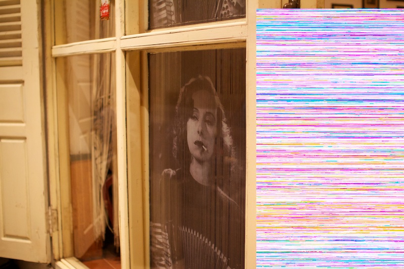

There was a couple of image files that I was not able to recover at all, with either tool. It simply look like the files themselves were damaged, or neither tool was able to find the remaining fragments, because all of them were much smaller than they should be. There are a couple I'm really gutted over - most my pictures of someone awesome I met randomly. Most of them are simply not there, and a few look kinda like this:
