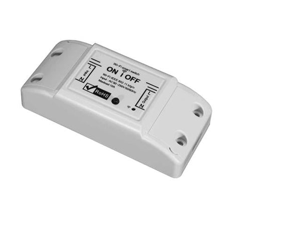

Well for lights that you want to put on a timer and not really need a manual switch, you can just remove them from switch and put one of these inline somewhere on its wire.
That won't give individual light control which i imagine is the ask here
Yeah, would unfortunately still like to be able to control the lights manually irrespective of the timers.
And trying to get the in line controllers installed is going to be even a larger ball ache than expanding the hole to put 2 3 switch panels in.
