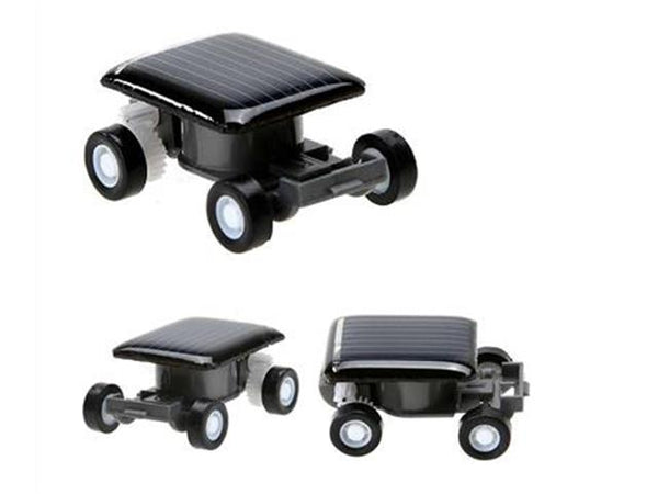

I bought 3 x of these for my kids and one has already broken. There are only pretty much two components (panel and motor)- so I assume it’s the little motor that broke.
I want to put the panel on something else because I have it - globe? LED? Another spinning motor? She’s only 3 - but I want her to see the sun powers things.
What sort of wattage would this tiny panel do?
Drop it in the sun and get a multimeter on it and measure voltage, measure current and times the two to get wattage..
Don’t have a multimeter - but I guess I can borrow.
I’m also thinking that the motor may have some writing on it and I can just replace. These things seem to be dirt cheap
Oh it’s likely tiny. Even this at much bigger is 1w …

Probably a single cell so only 0.5 V or so, which will make it impossible to light an LED by itself.
Tiny motors, electromagnets - wind your own and see what it can do?
She's 3. But you can blow her mind by making blinky night lights and stuff for her with one.
