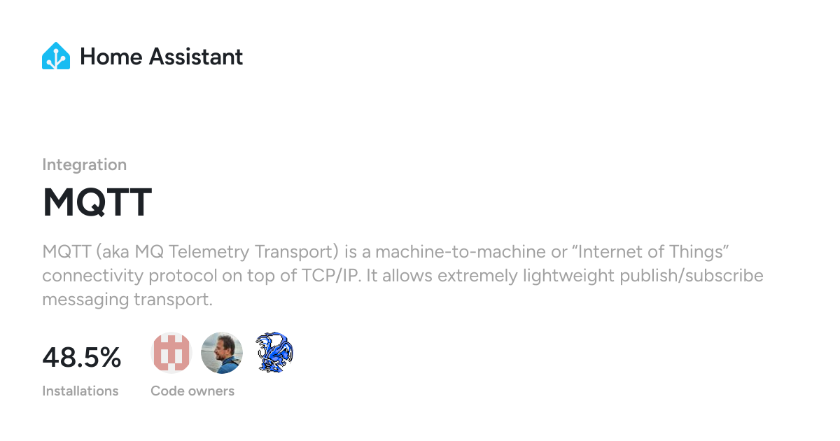

Hey, I am trying to replicate this but my installer provided a wireless dongle the plugs into the RS-485 serial port and so I want to connect to that. Has anyone done that? not quire sure as to what config I must use.
I have MQTT:
and the sunsynk plugin from github:
Scroll up.
You use the other port, the integration has nothing to do with the dongle.
Buy a cable from Solar Assistant.
