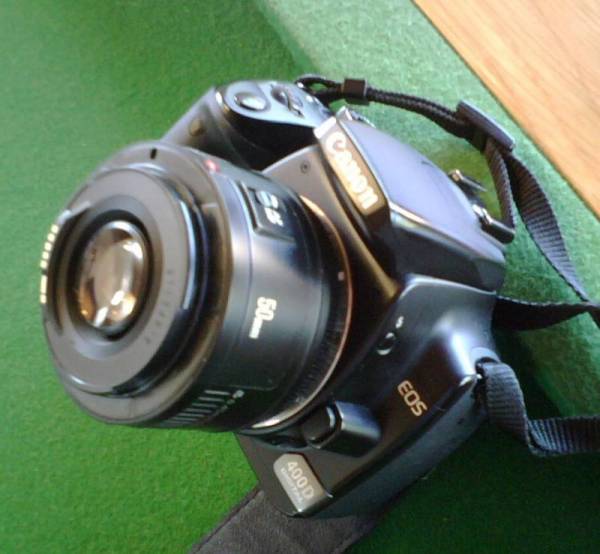

DIY - flip your lens around
no - a teleconverter increases the effective range of the lens.
Yeh I took a few shots like that today. Must say I'm quite impressed. Just a nuisance to keep holding the lens to the camera. Did you use a reversing ring?
No - elastic band.

You get reversal rings like this. They're pretty inexpensive, but you need one for each thread size, since they screw unto the front thread.
You also need two lenses to screw into each other.
The nice thing about the 50mm is it fits in snugly and doesnt slide around.
