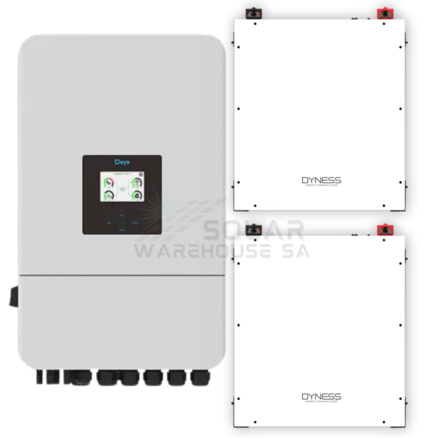

We finally want to pull the trigger & go Solar
So after all the advice we got yesterday we have been considering this type of system above, with the exception of either a single smaller battery to start with - or, reduce the panels to 12 (but acknowledge what others have advised about prioritizing panels over batteries rather) I realize its not ideal but will allow us to buy the hardware and hang onto it while we have a little more motivation to put away for the installation a bit later. Pricing looks much better than when we looked 3 or 4 years ago and it seemed out of reach at 250k, I don't how fast that can change with current world affairs but would hate to let current prices slip and find it has doubled again when we ready
12 certainly makes a lot more sense than 4 and at 600W panels is more juice than I have overall so you’ll be styling especially if they are all north facing.
But really it also depends on your current usage so maybe you can elaborate on that, because chances are this is the sweet spot and you don’t really need more.
Do you plan to put the geyser on there? Stove/oven? Any other big draw surprises?

If you can oversize the system, that leaves some headroom for when you later add an air conditioner, pool pump, or something.

Don't do that. Why run through your warranty while it just sits?
So you have 3 day outages, but you have a generator already correct? Keep that. It's not economically sensible to try to use batteries (with or without solar) to cover that length of outage -- that's basically off-grid, which should be considered a hobby project for fun, not an investment in the sense of putting your money to the best possible use.
If you are looking for to make the money go furthest then you need to shrewd about when to stop. The ROI on the first R10-15k (geyser MPPT) is huge - it's a 2- or 3-year payback. The ROI on the last R 10k can be very low, worse than leaving your money in a savings account.
Most people are in favour of a wham-bam one-shot install of the biggest system you can afford because of the overheads. But I think it can be better to do it in two parts, if only because you don't know up-front what remains after you've invested the first R 10 or R 20k. In my case, having put my geyser on solar a couple of years ago for R 12k (an easy DIY job), I re-run the numbers now and then and it still doesn't make sense for me to do a full system. What little remains of our grid consumption now means the payback is just too long vs. investing the money elsewhere.
If we'd done an 8 kW system and put the geyser on it back in 2022 I would know no better, but I dodged a bullet. The money not spent has grown 50-80% by now.

You are close and you could get a smaller system installed but honestly I'd say make sure you get a decent size inverter.
Something like:
Phase 1:
10-12kw inverter R33000
5kwh battery R15000
6000w panels R18000
Install R30000
R96000
Up to 900kwh saved a month but realistically budget for 300-400kwh due to single battery
Phase 2:
2x 5kwh batteries R30000
6000w panels R18000
Install R20000
R68000
Up to 1800kwh saved but realistically 600kwh+ due to limited batteries.
Phase 3:
3 more batteries
R50000
Up to 1800kwh saved realistically 1200kwh+

No, this is why I'm saying be careful about when to stop.
Electricity usage is very non-linear: there's a base load of 100-500 W that is constant 24/7 (fridge etc.), but then you might have a few hours at 1-3kW (geyser), only a few minutes at 5-8 kW (oven + kettle), and maybe a few seconds every few days above 8 kW.
When you provision to supply 12 kW, the amount you pay over an 8 kW inverter, let's say R 10k, is barely generating any value. Over 10 years it may only have done 10 hours of work.
If that's fine by you to avoid tripping the inverter once and learning what not to do then great, but for most people that's the definition of a white elephant. A real waste if you spent months saving that money. It's just you can't see it because it's all part of the same oversized unit.

They have two households though. The main house and also a flat. That means its more likely for multiple things like microwaves, kettles etc to run at the same time.
I have a 8kw sunsynk with 2 geysers, electric stove/oven and its fine but I'm running close to the limit so if there was a flat as well I'd go up a little in inverter size.
The 12kw inverter also has 3 mppt controllers which gives more future PV options.
