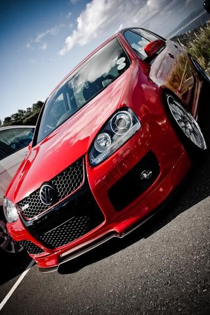

We need more motoring threads
:drool:
I really can't understand the fascination with boring station wagon look-alikes but then again there are certain types of gay porn that I also do not get. Guess you have to be in it to understand it.
