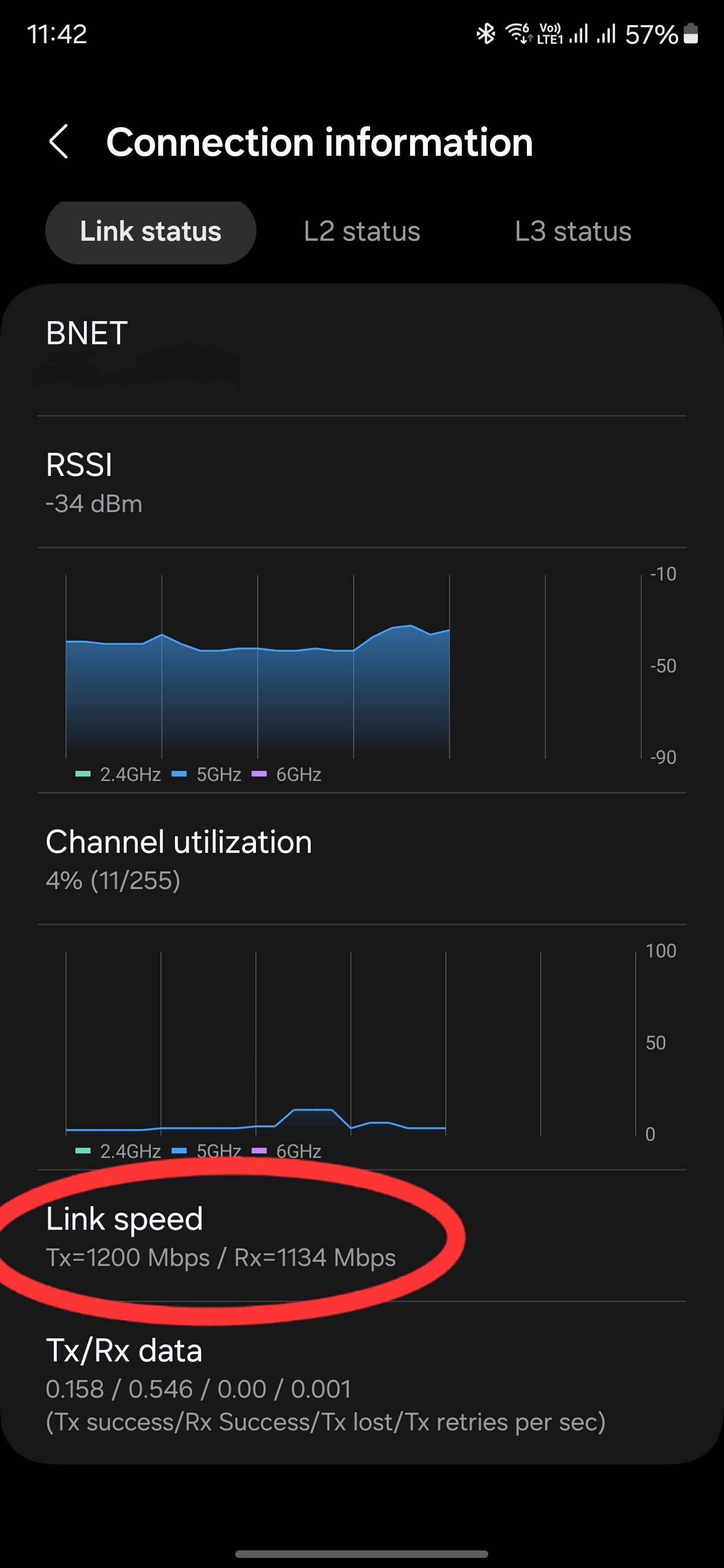

I've got a WiFi 6 system at home, with 5Ghz 160Mhz enabled for client side traffic. All my devices (that can) connect to the router/nodes at 2400Mbps, but for some reason all of my Samsung devices will not connect anything over 80Mhz (resulting in 1200Mbps connections). I transfer quite a bit of content between devices at home, and wonder if anyone else have noticed this and found a fix for it? I've tried disabling DFS channels, didn't work and also disabled all battery saving function on the Samsung devices and that didn't do anything either.

is that screen shot from the phone in question? or just a prove that wifi6 is broadcasting?

it's a screenshot from one of the Samsung devices (Tablet). Not sure where you mean I should start, if you are referring to compatibility that's what I'm trying to figure out. There's no clear spec on Samsung devices around what's supported, but there seem to be some indication that Samsung (for a while now) should be able to utilize 2x2 160Mhz 5g channels. Would be great if anyone can confirm if they are able to establish a 1200Mbps+ connection on a Samsung device with Wifi 6 (Tablet or Phone).

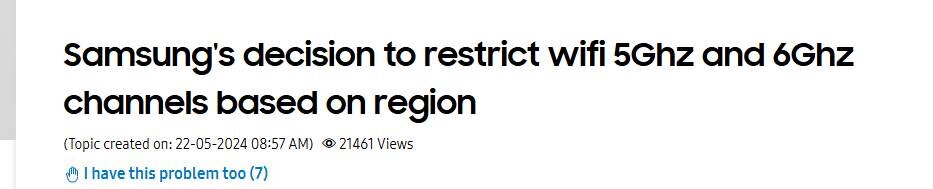

Thanks, I saw that article during some research and unfortunately that's not it.
This is the closest I could get - but NO closure...
Beginning to wonder if the devices aren't capable
I think they technically are capable, but if Samsung region locks them for some daft reason in the firmware, you'll be SOL
send us the specs of the devices let's help you. Let's just say this, if your device could do 160Mhz it would. Samsung doesn't do the dirty on one contrary to belief.
1200Mbps is the combined effort of the wireless 2x2MIMO @ 80Mhz but that is not taking into account channel congestion noise etc. so if your wifi can do 1200Mbps it's normal 1200/2 = 600 theoretically

Hows all your AP's connected? are they meshing or are they all wired for sound
Thanks for offering. These are the only specs I can find on the device side of things:
S24 ultra:

Wifi is meshed (dedicated bachaul channel), Asus zenwifi - xt12 x 2 linking upstairs and downstairs, branching out to 2 x xt8, 2 x xd6, and 2 x xd4's placed in line with traffic and usage requirement. Fronthaul 160Mhz channels available on xt12 and xd6's. PC wired into main xt12 router.
Laptop connects to all nodes with 160Mhz fronthaul available at 2401Mbps, all Samsung devices max 1200Mbps, including the main router whether next to it or 5 meters away.
I do, got really excited there for a second! Switched off on both bakchaul and front, forgot the wifi, restarted and reconnected. Still 1200
