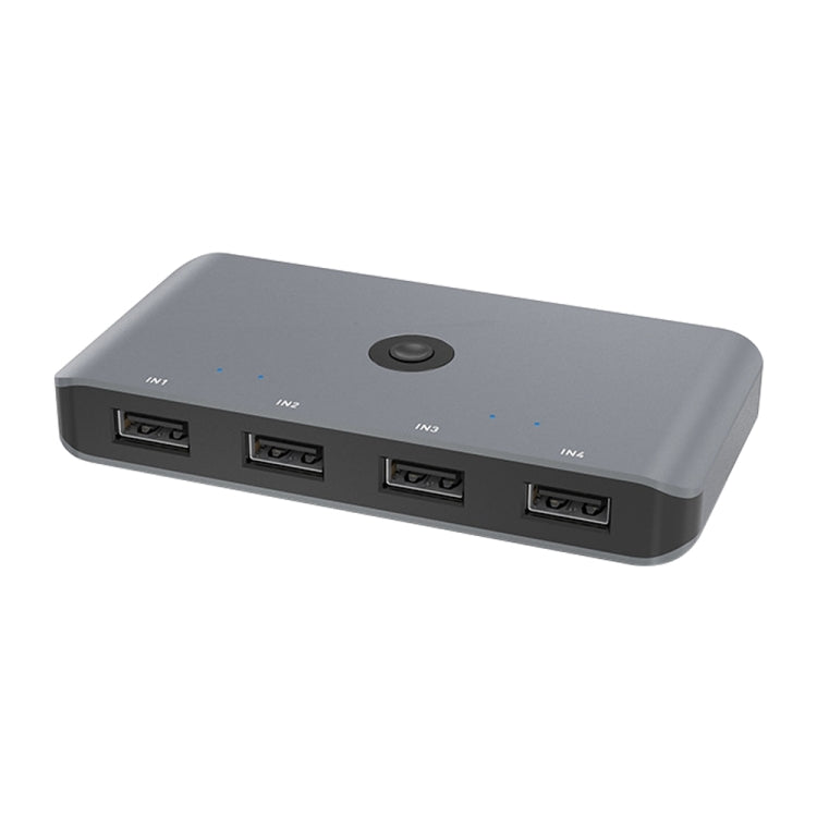

Unless I am missing something, this only accepts two PCs...
if all else fails then i think it will need to be 2 devices
this one to take care of the input devices (KB/mouse/headset)
and a separate switch for the monitors
