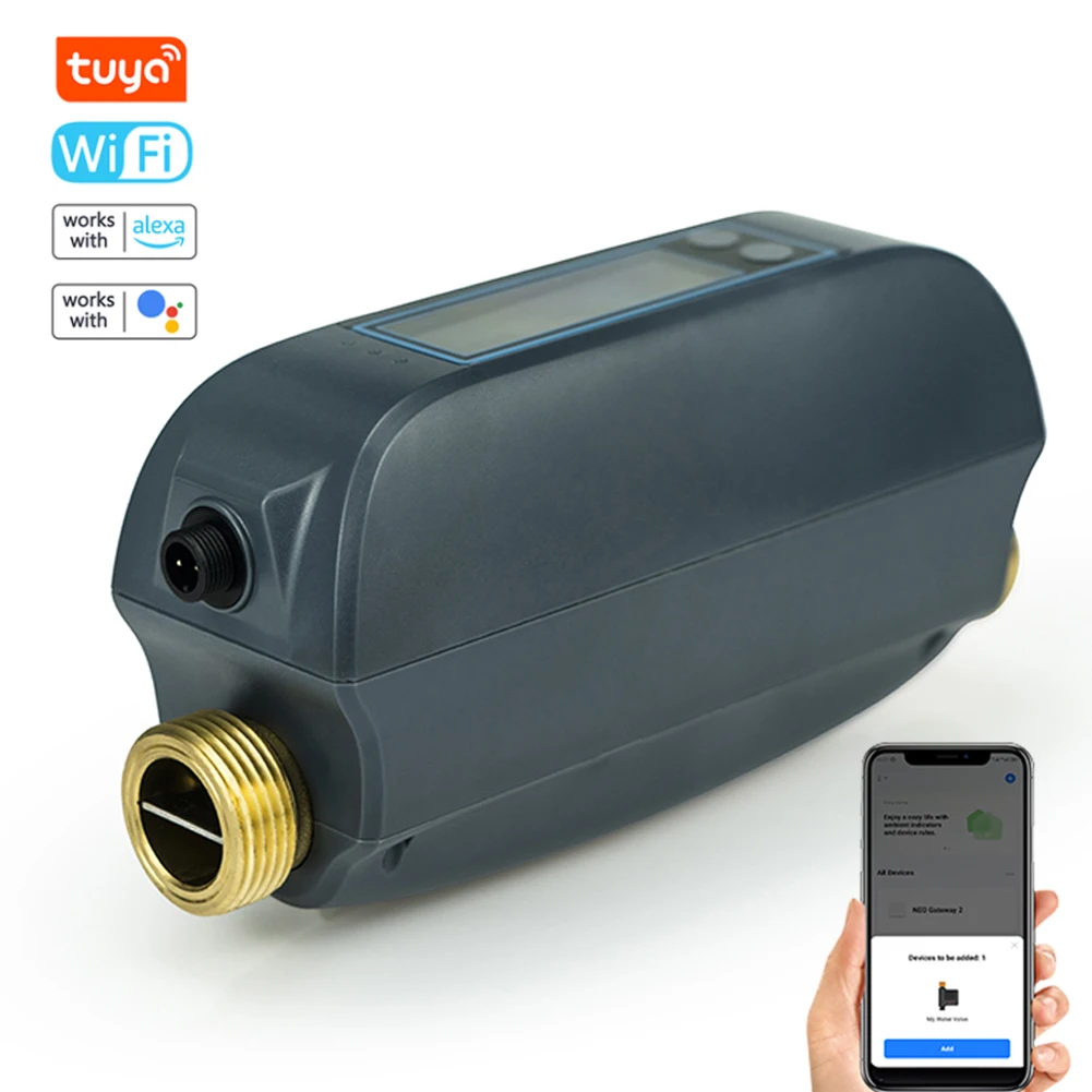

Regarding the water, I have been looking around for something like this:
I have my eye on this.
Tuya Smart WiFi Water Valve
APP On/Off Control
Water pressure / Flow Rate / Temperature measurement Water consumption monitoring
It’s super expensive in my eyes, but about half the price of that Swedish unit! I like that you can monitor water pressure, eg shut off the valve at 3am, and watch for the pressure dropping, to indicate a slow leak. Fast leaks should be discernible by continuous flow. Temperature not that useful, I guess!
APP On/Off Control
Really cool indeed! Only concern would be if I can integrate it into HA, via Tuya Local or Official Tuya...
Well, it claims to be Tuya, so I expect you can, like any other Tuya device. Personally, I’d be looking at LibreTiny to make an ESPHome firmware for it.

After looking at the reviews, some people had problems with that one - So I decided to shop around a little more and found this:
Worked out to just over R3k, which I have ordered and should be delivered by 9 Feb
