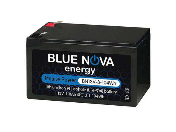

will the blue nova lithium batteries work in the APC UPS?
Specifically: the APC BR1500GI
Been using 2 of these babies in my Eaton 5e 1500VA for over a year now, has survived some up to 5 hour outages and all the loadshedding while powering my ONT and router continuously.
The Blue Nova batteries are lithium but they have a BMS built inside and are a 'drop in lead replacement'
It is lithium, but whoever it talks to it speaks lead acid language
So a normal lead acid charger looks at it and thinks it is a lead acid battery
Oh yes, Blue Nova says one must get batteries from same batch or something (it's on the sticker), if going to run them in series, like in a 2 battery UPS like mine.

Will the UPS let the battery discharge to 0, all the UPSes I owned shuts off very early not sure if that that ups setting or lead acid invoked.
The drop in voltage with a lead-acid is linear, with lithium the battery voltage stays more or less the same, there is a very slight drop in voltage drop, and then at the end it will drop suddenly.
I think you should test it with the Blue Nova batteries from Takealot and take measurements in testing, if you dont like it Takealot has a 30 day returns no-nonsense policy which is pretty good from my experience.
UPS setting almost all will switch off at about 2 hours no matter the battery size or remaining amp hours.
