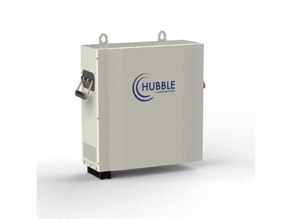

Thanks for all the feedback its greatly appreciated.
I'm really more confused now with all this :-(
This is what the Inverter looks like.
There are no buttons to check any data or change any settings.
I do think its set at 10A charging
I'm not able to get into the cabinet to check the battery configuration.
Would I be able to connect one of these batteries,
Without having to change any setting?
Just connect positive to positive negative to negative.
My partner found these two possible ready solutions for her mothers Oxygen machine.
or
Or if anyone knows of a company that they can recommend that I could contact or get to come out and chat to us about the options.
This is quiet urgent now :-(
Thanks, Appreciate
Found your inverter, http://www.truepower.in/images/hulk.pdf
Specs are kinda useless. Only really confirms 10A, so 48V*10A = 480W, or ~500W charge? To charge up the 8000Wh battery capacity that you need, from 0% to 100%, will take 8000Wh/500W=~16h. But we are working with a lot of hypotheticals here.
The batteries and complete systems you linked will not have enough capacity to carry the load you mentioned.
If I were you, I would start off with getting a kill-a-watt/clamp meter to check exactly how much just the oxygen machine uses, power wise, because then one can do a few proper calculations.

I would not use either of those batteries on your inverter if you can't change the charge voltage
The first is a lifep04
But it is a 15s 48v battery
And the second is also a 48v battery but based on different chemistry it uses the 3.7v cells in a 13s config to get to 48.1v nominal voltage
Sure the bms will be a safety net , but i would prefer to have a 51.2v battery
Ie like the lifepo4wer battery that is a 16s config
If your usage is 450w then your current inverter will be able to charge back what you use in a 4hrs loadshedding stint ie you would use 1800wh approx and be able to charge back about 1920wh

If you can set/change the charge voltages you could use either of the 2 batteries you posted about on your existing inverter
If not you have to get a 51.2v nominal battery
The term 48v gets used way to generic imo
48v nominal is 15s battery
And 16s 51.2v nominal voltage
Yet many listings refer to them both as 48v batteries sometimes , some sites do state the nominal 51.2v
Ie a 12.8v (4s) lifep04 matches 12v lead acid default charge settings 100%
And hence 4*12.8 = 51.2v matches 4x12v battery default charge settings
And thus why you want a 51.2v 16s battery if you can't change settings
Like i said the bms will be a safety net. And can prevent even the 48v batteries from overcharging but may keep them at a higher voltage that some say may affect life expectancy (salt based on opinions on the internet)
But prefer to get the batteries closely matched to existing for device standard charge settings + default overcharge protection

Another 51.2v example
That should be able to carry the load for more than the 12hrs if need arrises
And if you find that you have more outages that exceed inverter charge rate you can decide the way forward
ie can buy another inverter later or add panels or additional charging
