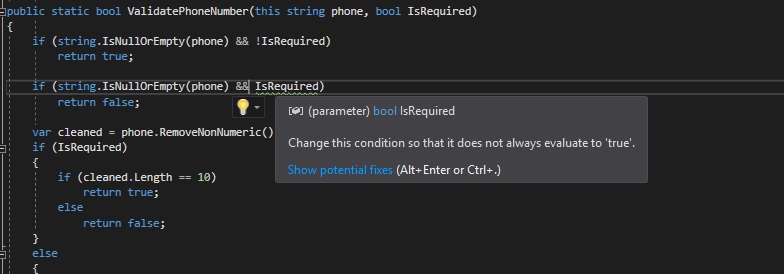

Is this what you call a false positive?
C#:
public static bool ValidatePhoneNumber(this string phone, bool IsRequired)
    if (string.IsNullOrEmpty(phone) && !IsRequired)
        return true;
    if (string.IsNullOrEmpty(phone) && IsRequired)
        return false;
    var cleaned = phone.RemoveNonNumeric();
    if (IsRequired)
        if (cleaned.Length == 10)
            return true;
        else
            return false;
    else
        if (cleaned.Length == 0)
            return true;
        else if (cleaned.Length > 0 && cleaned.Length < 10)
            return false;
        else if (cleaned.Length == 10)
            return true;
        else
            return false; // should never get here

seems legit to me
it cannot be anything other than true because you already tested if it is false with the same precondition before (is the string null or empty)
Read it like this and it will be obvious
Code:
if (true && false) {
   return true;
if (true && true) {
      return false;
//So now, kind of like “solve for x”, remove the duplicates, and you get
if (false) {
   return true;
if (true) {
      return false;
//which is basically
if (false) {
   return true;
} else {
    return false;
// OR
if (false) {
   return true;
return false;

Agree with this. If you nested, it would be even clearer:
Code:
    if (string.IsNullOrEmpty(phone) {
        if (!isRequired) {
            return true;
        if (isRequired) { //shouldn't ever be anything else; so why bother checking?
            return false;
Perhaps not my place, but style-wise, something like the following "feels" better to me:
Code:
public static bool ValidatePhoneNumber(this string phone, bool isRequired)
        return !isRequired;
