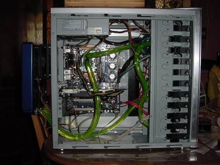

I want to start getting my WC parts this month:
CPU - Swiftech Apogee GTZ
North Bridge - Swiftech MCW-NBMAX
Rad - My current rad. A Danger Den Black Ice GT Stealth 360
Res - Swiftech MCRES-Micro Rev. 2
Pump - My current Swiftech MCP655
Tubing - Tygon Silver Antimicrobial Tubing
Things I've learned over the years:
1. You can go with a T-line instead of a Res, but it's a mission to bleed.
2. Try and keep your entire system copper. Mixing metals is not a good idea in the long run.
3. !!!!Test run the system!!! 24 hour run recommended.
4. !!!Clean your parts first!!!*
*Use white vinegar rinse out your parts, but for your Rad fill it up and leave for an hour or so, then shake it up and drain. Rinse out all the parts with distilled water.
This is why you should clean out your Rad especially. That's all the gunk I got out of my first 240 Rad.
The better you clean your parts beforehand the longer it'll stay clean. My previous setup lasted almost two years before it started going milky.
My old setup Still had my old Rad and Res then. My new setup will be installed into my new case (Cosmos S).
