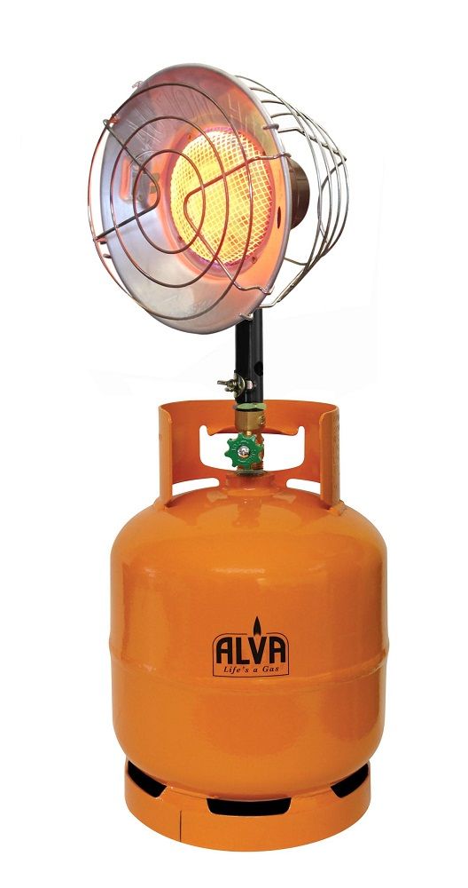

Electric heater.
Poofters.
You make your passenger hold this:
