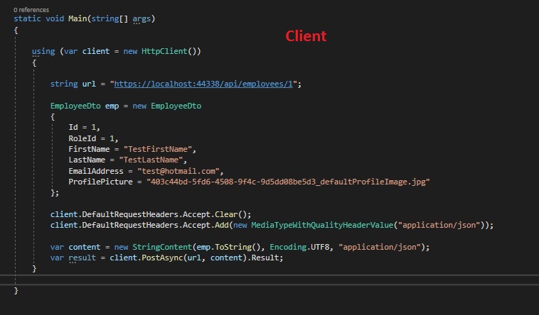

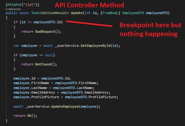

I simply cannot see the problem here. Granted I've been staring at this project for a while now and starting to hard code **** in desperation. Please someone suggest what I have done wrong here! :X3:
In short, the client will simply not send the update request to the API.
Strange. Integrated this and it works now. It is definitely something to do with serializing objects to json first.

What does your EmployeeDto.ToString method look like on the client implementation?

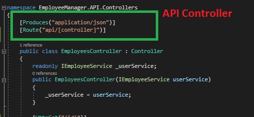

I reckon @Barbarian Conan got it right, so I will do some code review instead ;)
  • Remove the [Produces]. If a client wants XML, let them get XML (dotnet core has some built-in converters)
  • Ignore the ID in the PUT body. I don't think it adds much, and in general, PUT replaces an entity's data, but you really should not be updating the ID, which is likely a DB key that makes no sense to update.
  • Extend ControllerBase instead of Controller if you don't need view support.
  • Add [ApiController] attribute if this is a pure API controller, you get some goodies out of the box - https://docs.microsoft.com/en-us/aspnet/core/web-api/?view=aspnetcore-5.0#apicontroller-attribute

client.PostAsync(url, content)

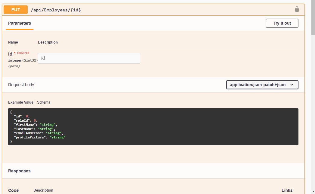

What concerns me a little is that now my swagger doesn't look like that anymore now that I've removed the curly bracers. It still works but it looks different with now just a api/employees/id
Does it make a difference?
bit of a typo there from @Barbarian Conan, but the lack of braces has no bearing on your original problem. Look at your verbs, specifically what your endpoint expects and which verb your client makes use of.
