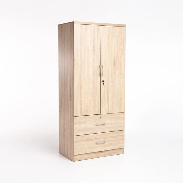

Wife is looking for two wardrobes with some drawers. I said I'll make it but she doesn't want to wait. The stuff I saw in the stores were pure junk.
She found this one:
Width and depth is okay but the height is not great. 2.1m height would have been better.
Anyone know what the quality is like for these decofurn units or know of something similar but better quality.
She found this one:
Seen them in store.. terrible quality.. edging is basically paper and drawer runners are not the ball bearing version..
diycupboards.com has 2100mm height cupboard with drawers, though I think they still running non ball bearing runners but you could replace them with ball bearing runners..

Take the news to wifey that no one delivers to KZN and it's best and cheaper she waits on you to make it..
You'd be in for two sheets at most I imagine, so looking at about 1600bucks for the sheets (assuming your local board stores also run CPT prices) probably around 600bucks in edging and then another 300-400 bucks on drawer runners and handles depending how many drawers you do..
I was thinking of using MDF / Supawood and then paint it. Don't like the chipboard melamine, but it is an option as well.
I would not do MDF for cupboards.. it doesn't hold on to screws very well and is very prone to splitting.. it absolutely will absorb every bit of moisture it can..
It's also considerably more expensive than chipboard..
