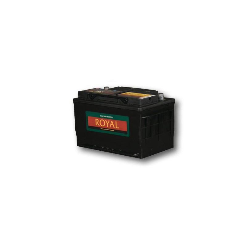

Get yourself some cheap batteries like the royal ones that are sometimes on sale for under 2k
