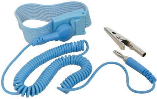

I had this problem for years in our previous office. No one else in the office had the problem. Seems to have been caused by the combo of the type of carpet and my shoes. Got so bad I once tied a electrical cable from my wrist to the closest tap, that earthed me and worked for the day but obviously not practical. I also tried an anti static wrist band but it was a cheapie without a crocodile clip (had a capacitor or something) and that only helped a little bit.

4. Anti static wrist band:
