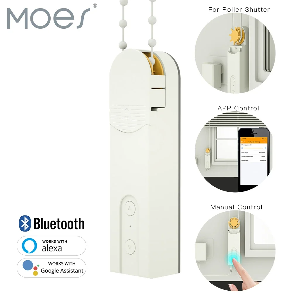

Is it possible to somehow capture/repeat bluetooth messages? interesting in automating our rollerblinds, and thinking of trying something like this:
This might be better:
Don't think so. Looks like it is encrypted reading http://www.fte.com/WebHelp/BPA600/C...LE/HowEncryptionWorksInBluetoothLowEnergy.htm
