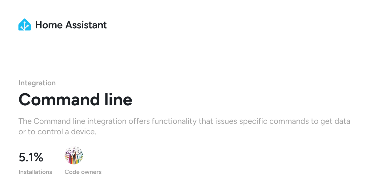

what do you have? i have this
- platform: command_line
command: "curl https://loadshedding.eskom.co.za/LoadShedding/GetStatus"
value_template: '{{ value | round(0) | abs - 1 }}'
unit_of_measurement: "Stage"
scan_interval: 600
Same, excepting for a timeout on the curl statement, and no scan interval - I'll add the scan interval, see if it helps.

How would I add this to my configuration.yaml? I've added it under sensor: but it doesn't show up.
You likely need to go look for it in Unused Entities. It won’t just show up by itself.
what @SauRoNZA said.
so i have that entry in my sensor.yaml
then on the ui i have this under badges.
- entity: sensor.eskom_ls
