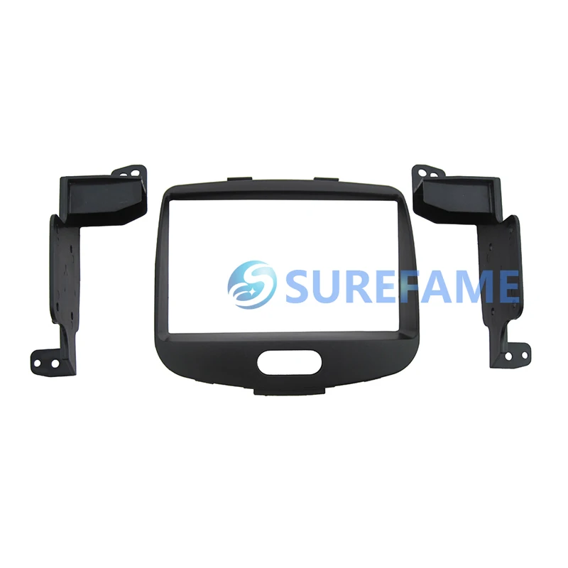

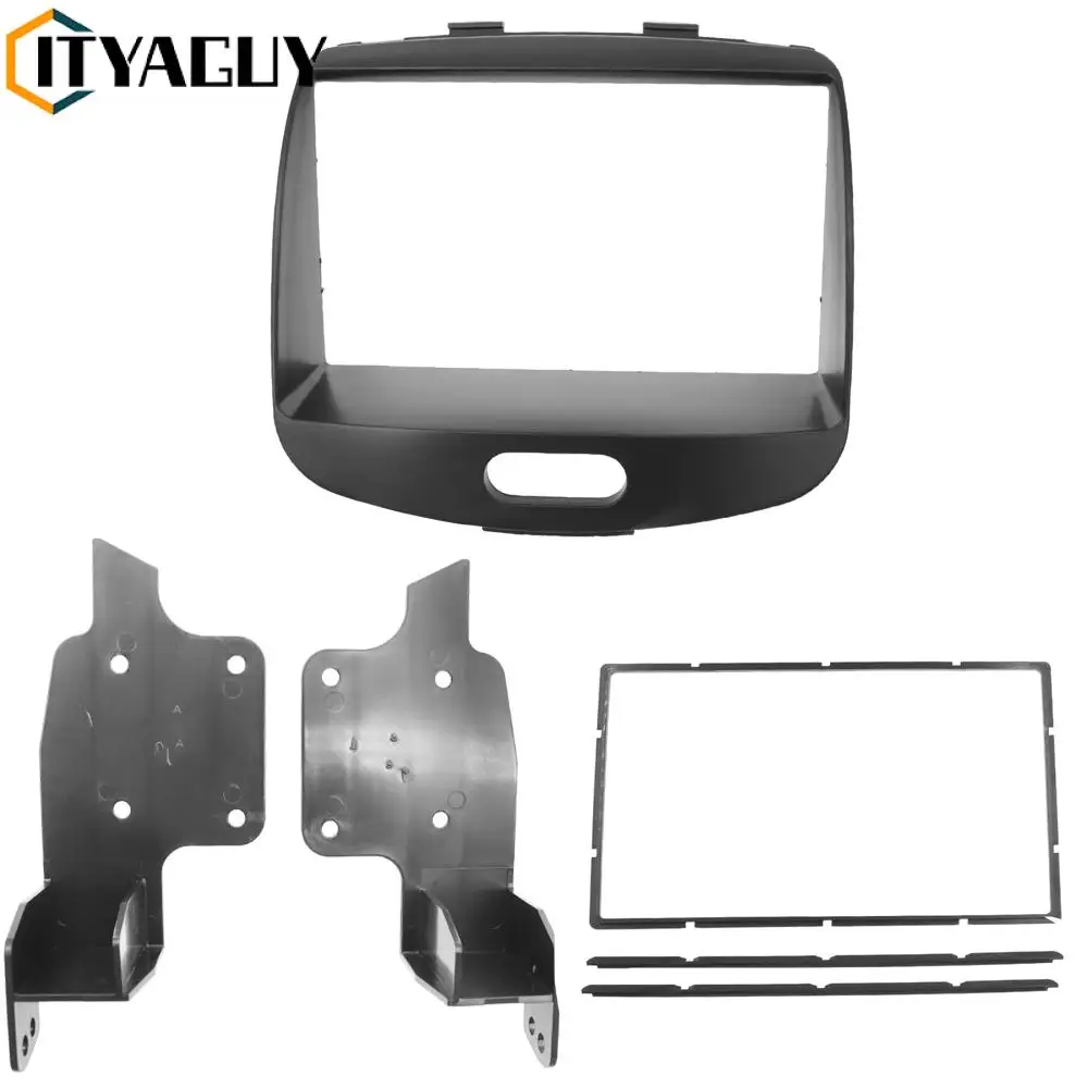

This is the closest thing I found but Im not sure if it will fit:
