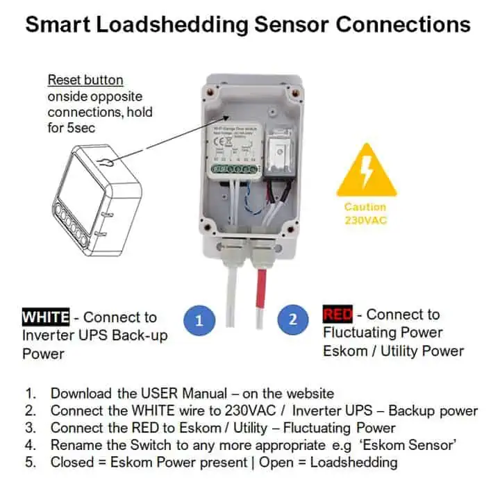

I've got a small load shedding system in place for a few essentials (ie working, lights, tv etc)
But, my SO doesn't realise when it's load shedding and worried she uses something that ideally shouldn't be used, and either trips or drains the battery . In the study, I have a light that tells me the grid is off ... but no where else.. What do you guys do to know when there is no grid power? I guess a simple simple lamp left on can do it ? Anything else ?

There's a Loadshedder type solution for Sonoff and Tuya-based systems
Basically a Reed-switch door-sensor combo if you want to DIY it
If Door sensor = open = Power Off

And the Sonoff, I understand, is really just going on the schedule and not actual grid? At my folks, for example, they have no power for 24hrs+ and the helper tripped the inverter unintentially as she never knew the power was out. I've got a small red light in the study for grid on/off - but I'd like have it in the kitchen too with as little effort as possible .
I even thought about one of those Tuya light intensity meters that I can place near the existing red light
You can hook the sonoff up to ITTT type thing somewhere, it just needs to be triggered. If you want a actual sensor you would have to have someting in your db on your mains incoming otherwise it will be detecting the inverter.

Something like this.
or this
I have a ping monitor on my Mikrotik and a tuya breaker on eskom side,sends a Telegram message to a group when the monitor connects and disconnects from wifi
