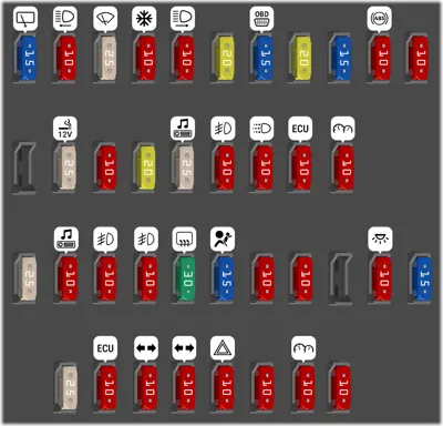

Hyundai Accent 2006 weekend away and heavy rains. Indicators don't work. Hazards DO work. All other lights fine. Checked all the fuses and they are all fine. Dash is cool. I did notice quite a bit of moisture in the RH door/side indicator housing.
Do the indicators have a different relay to the hazards' ?

Are you sure your actual fuse box cover lines up with that image? It's very odd that there is a fuse for each side.

The fact that both sides aren't working tells me it's not a fuse problem but something else.

It's the same as the image. It feels similar to me. Relays are difficult to check if there is another one for the indicators as its behind the fuse box.
Then it’s likely not the relay as it’s one and the same for hazards and indicators.
So I would think the stalk switch. If it was wiring I’d expect it deeply unlikely both sides would fail at once but not impossible.

I've managed to get the indicators sorted by just replacing all the fuses. Today my wife told me the cars lights are still on. Went outside and saw the break lights are on. Can't get them to switch off. Had to disconnect the battery. The front and rear fog lights also dont work.
