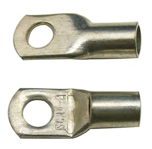

Connect them using 25mm or 50mm cable. 50mm if you can afford it. Remember, if a cable says it can do 100amps doesn't mean you WANT to run it at 100amps because the cable gets hot and there are plenty of loss there.
Either cable can be had at Belco Electrical (Voltex) in Woodstock (50mm was ±R70 a meter). They also sell the crimps that fit on the Excis batteries (±R7 each). Make sure to get the right size (for the Excis battery lug and wire size).
