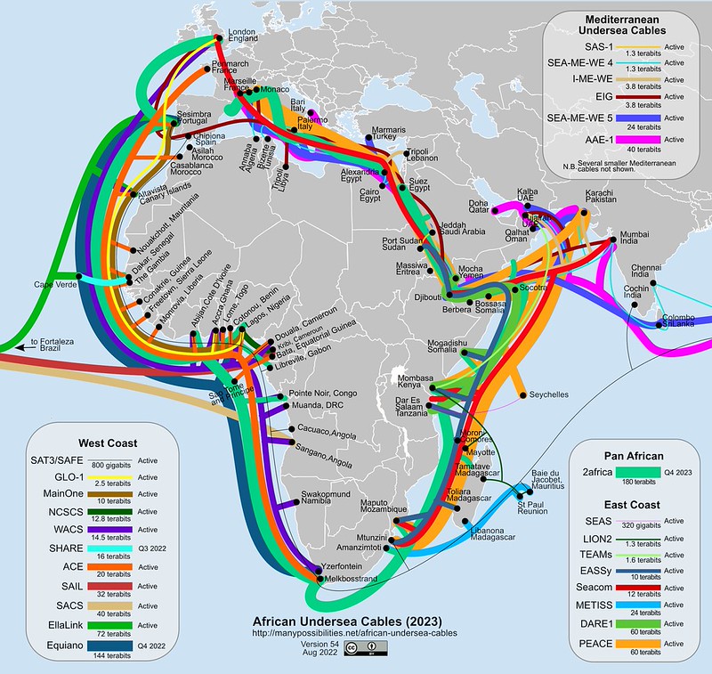

OP, an ISP makes use of multiple undersea connectivity providers in order to connect you to the world.
The key to getting better ping is finding out which ISP has the most favorable peering for your route.

WOW is 180ms at best from ZA, no way around it. Most ISPs use SEACOM cable up the east coast
