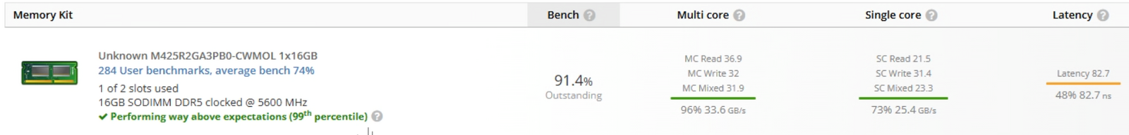

Would have been a waste to run this beast with just 16GB DDR5 in single channel mode and it's basically the last hurdle before I can replace my current 32GB mini work PC with the OptiRex. RAM is important since I'm always hovering around this usage even on slow days...
Managed to find and order another 16GB DDR5 5600 chip for R2K... which is a steal when you look at current market & 2nd hand pricing.
So now I could drop in another 16GB compatible DDR5 5600 Sk Hynix chip I had in my Lenovo Laptop then I'll drop the new Crucial chip in the laptop once it arrives.
Before memory upgrade:
After memory upgrade:
If I ignore the little bits and pieces I bought for the CPU heatsink mod, the entire system with memory upgrade cost me R10,500.
