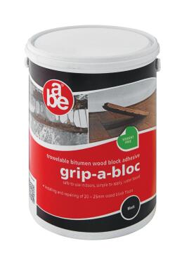

Example I can buy?
Play around with the stuff. If you're not careful, you'll end up with a bulge of bitumen that sticks out of the floor, because it gets squeezed up when you push the block in. But if you use it right, that once-loose block will never move again.
