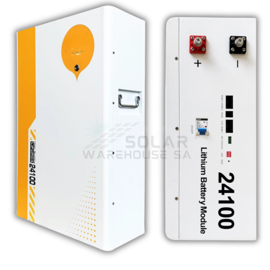

geewiz tend to use the axpert units mecer etcAre there any (or do you have) general recommendations as to what brands or specific models of 5kw inverters and 5kwh batteries to go for in a setup like this? Like something that can be hooked up together in a temporary trolley setup and permanently installed at a later stage.
It's very logical (at least to me) to do it in steps like this if one can't afford a permanent install right off the bat. The portable power stations with UPS features are just convenient due to being all in one, compact, not very noisy, easy to hookup to loads, etc. You're dead right about it not being a great value proposition for people who don't require the portability though.
it depends on budget, if you know you will do a permanent insatll at some point i would say buy a luxpower or any device on the approved list of cape town
as many say at some point most municipalities will adopt the same stance
for tight budget i would just use kodak or similar axpert models
i would go for a kodak or any model that segen supplies as they sell spares if needed in future
lithium i have no idea, have not seen many batteries open though most use the same seplos type bms (which are equaly crappy imo)
the cell manufacturers there is only a handfull in china so cell wise you will get the same cells in most batteries
where the big difference comes in is warrantee and cell matching so assume the pricier brands you may get better quality control
though i doubt it, warrantee you may be luckier with a bigger brand name though
