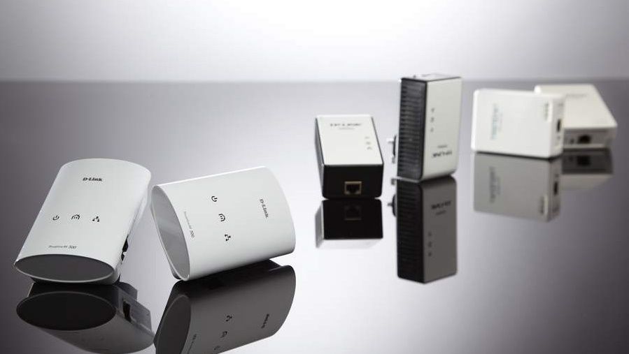

Ignore the Telkom landline points completely and simply install an off-the-shelf 'Internet over Power' networking solution instead.
See these articles for details.
It will only work if the two outlets are on the same circuit, which is not always the case.
It also does not work during loadshedding, i have a mini ups that provides battery backup
You can't leave your bedroom during loadshedding?
