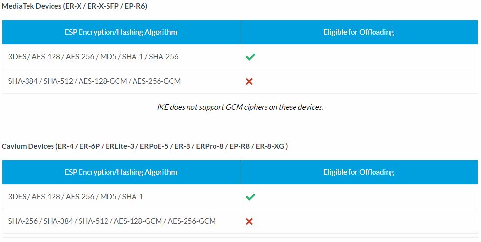

I wonder if that is with HW offloading enabled? I know the ER-4 has a Cavium-based SoC and the ERx uses a MTK chipset, so there may be some differences there too.
OP uses OpenVPN, not IPsec. There's many benchmarks and performance testing on Google to compare the two, that's why I asked the protocol in the first reply.

I understand that the hEX is supposed to have hardware encryption to allow up to 400+mbps. The VPN server is a dedicated x86 machine with a 1gbps connection, so it should easily handle 300mbps. CPU usage on the server side only goes up to 5% or so when bandwidth testing the VPN to it
Where am I going wrong?
Only IPsec is hardware accelerated.
