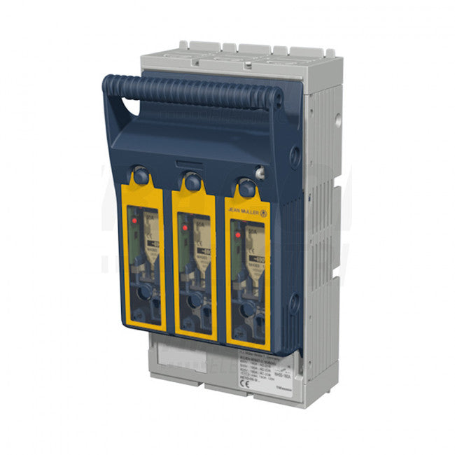

On a side note I'm connecting the batteries layer today. Should they have an inline fuse on the positive side as well as a breaker?
I'm thinking the breaker would be advisable when switching out batteries later.
Yes, both is good to have, otherwise disconnecting/connecting can be "fun".
DC Breaker so you can disconnect / reconnect safely.
Fuse so that you can protect in case of short or too much current draw.
I have one of these for mine (DC on / off) -
I have no idea how that works :D
Just basically a demand based cap that reduce the motor start spike on your power draw.
Personally I use/recommend a breaker. Just make 1000% sure you use DC breaker on battery and not AC.
AC breaker on DC power = Fire.
