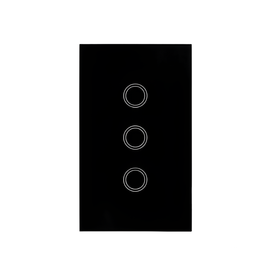

Have you tried this one? We've been using one for about 4 years (Tasmota) with no issue
