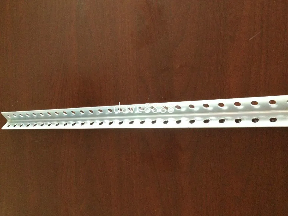

imo you should just build a custom one out of shelving material
this kind of thing:
Universal-angle-iron-angle-iron-bracket-angle-iron-fixing-frame-shelf-angle-iron-garage-door-fittings.jpg
it means no drilling or anything, simply, make an L with two of peices by bolting them trough the holes and then use a third as a brace to make a triangle, make two of those (or even 3) and join them together with 3 more peices.
then buy yourself 1.2m lintels to use as ballast.
this kind of thing:
