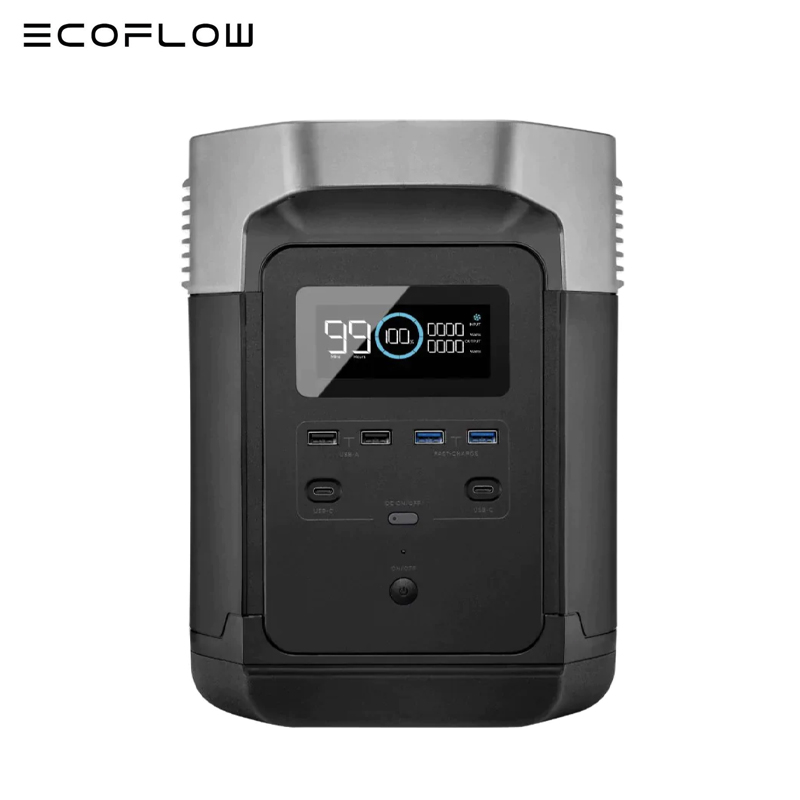

If you want to go Ecoflow route I would wait a month or so until the Ecoflow 2 models come out. These use LiFePO batteries which have >2000 cycles vs the 800 or so on the current Lithium NMC ones. The price difference should probably not be huge.

geewiz has this in stock, is this worth it to run +-150W usage for like 4-5 hours. also i'm not sure what the charging amps or timeframe of charging times are
it's similar prices to the ecoflow, but its got more wattage power and cycles
